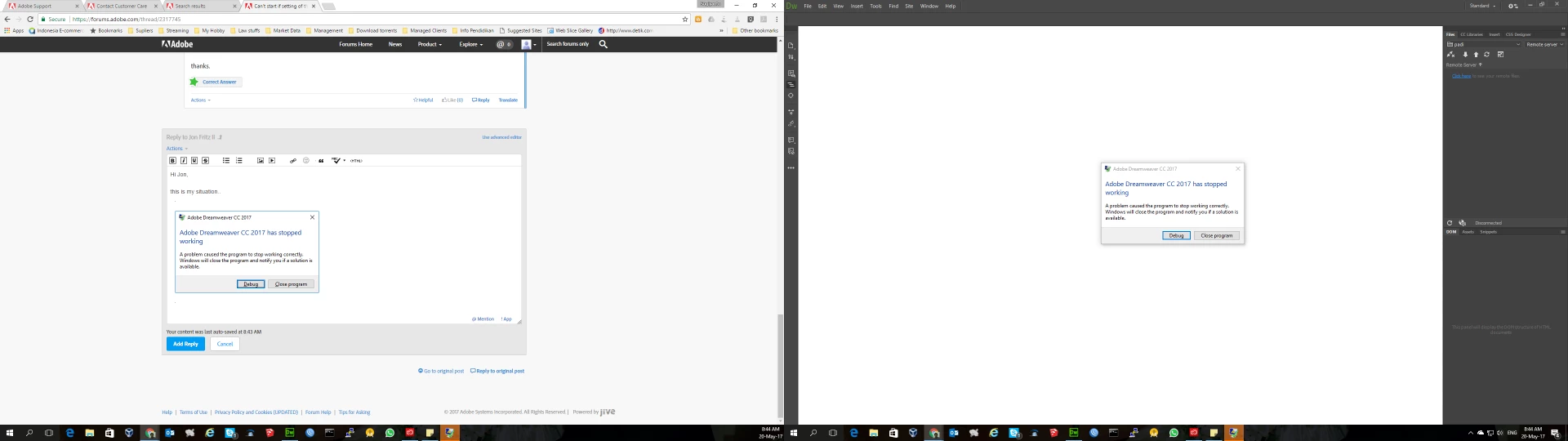

    May 20, 2017 1:38 AM UTC
    Hi nancy,
    my problem are when I start my Dreamweaver, it is crashed. before I can't change the View setting..
    thanks.

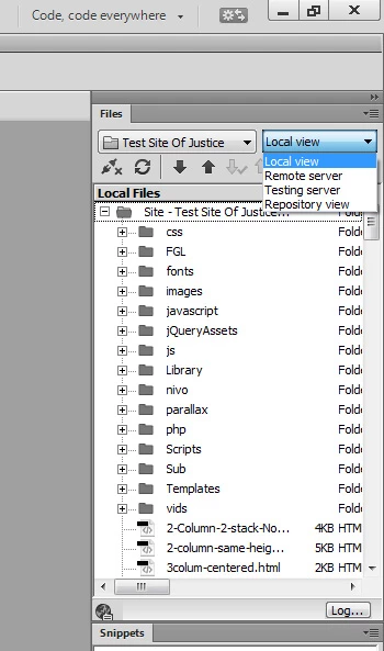

    May 19, 2017 3:34 PM UTC
    Expand your Files Panel.

    May 19, 2017 3:09 PM UTC
    Make sure your Local View is selected in the Files Window...
    May 20, 2017 1:44 AM UTC
    Hi Jon,
    this is my situation..
