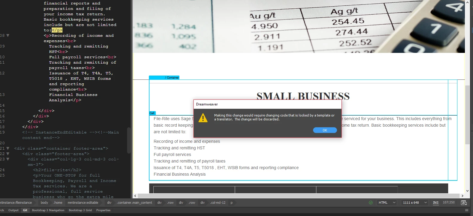

However I keep getting the following errors -see screenshots attached
when i create child pages from template it says l am making change requires changing code that is locked - etc ...

    Problem Fixed. On further investigation we found that the following was our problem. Resolv
    As for your issue - there are two problems on your template:
    ​1. You have jquery includes in a non-ediatble region in the page head tags, please move them in an editable area named "head" inside the head tags as otherwise, when DW checks these files and they are not editable you get these errors.
    ​2. You have not turned off the "automatic file update" option in Bootstrap 3 options: Tools > Commands Bootstrap 3 Options.
    NClifAuthorCorrect answer
    Dec 7, 2017 2:49 PM UTC
