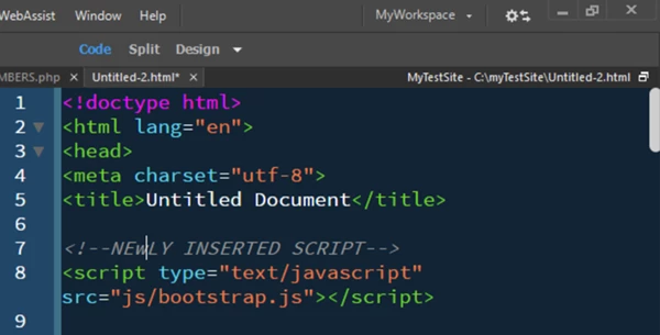

    I want you to be aware of the indicators in DW's Code View.  These will alert you to code errors before they become bigger problems.   In this example, I'm missing a closing </dv> tag on line 171 and my omission is being flagged in red.   The Output Panel tells me the unclosed  <div> started on line 153.
    In addition, DW has a built in HTML validation tool.  It's good practice to run validation checks often during development.

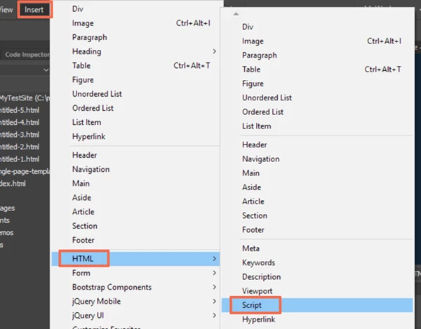

    If you're unsure of the correct syntax, delete the problem link & use the Insert Menu to add a new Script to the document.
    Assuming your site is properly defined, DW will create the correct code for you.
