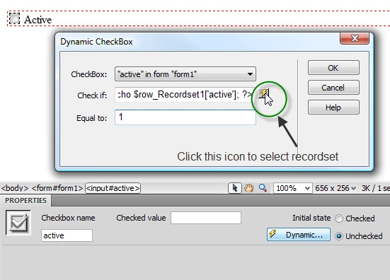

Yes, that's the basic principle of hand-coding it. Dreamweaver will also create the code for you automatically.
  1. Select the checkbox, and click the Dynamic button in the Property inspector.
  2. Click the lightning bolt icon in the Dynamic Checkbox dialog box to select your recordset field
  3. Type the value you want to use for the checkbox to be marked checked, as shown in the following screenshot:
Since you don't want the value to be changed, select the <input> tag in the Tag selector, right-click, and select Quick Tag Editor. Add readonly="readonly" to the <input> tag.
