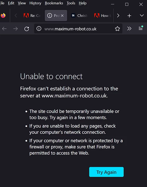

Nancy OShea
Dec 8, 2022 8:56 PM UTC
Unable to connect to URL.
