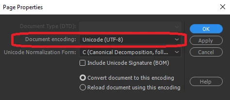

Can you please confirm the Encoding type of the document. We suggest you to try changing the Encoding of the document to the correct encoding type of the file downloaded. This setting is available within Page Properties dialog. You may have to save the document post changing the Encoding type.
You can invoke Page Properties dialog from File menu.
If the issue is still reproducible, can you please share the file with us so that we can investigate the issue internally.
Below is the screenshot for your reference.
Please confirm if this resolves the issue, else will investigate this further.
