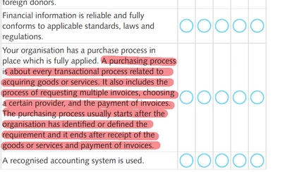

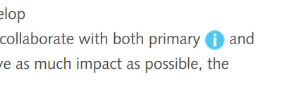

On our website we use a mouse over under an 'i' like in the picture below.
Now I also want to add an 'i' under which this text will be visible:

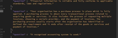

This is what it is like now, I'm using Dreamweaver:
I tried adding it the usual way with <span></span> and also tried <a href=" ">TEXT</a>
When using the <span> option the entire table disappears from my website and when I use the <a> option it just adds the coding to the plain text visible on the site (so on the website you actually see <a>TEXT</a>.
Since that didn't work I tried to mark the text italic with <i></i> so at least it looked different from the rest, that didn't work either and got the same result as with the <a>.

To get anymore information then give us a link to a page which already has the 'I' on it so we can see how your developer has done this. The developer seems quite adept as they have looped through a json array of questions to insert on the page.
Also be aware mouse over does NOT work on mobile devices if thats a concern.
Edited.
Im not even sure you will be able do this as all would need to be executed at the time of looping through the json array of 'question' objects.
You may just have to build a static table of questions and then apply the spans/classes to the specific text.
Try adding it to the json object text:
"question": "Your organisation has as purchase............fully applied.<span class='showInfoText'>I</span>
<span class='infoText'>A purchasing process is about................invoices.</span>"

The way I would normally use the 'i' is by using this code: <span data-tooltip="" aria-haspopup="true" class="has-tip tip-top" title="A purchasing process is about every transactional process related to acquiring goods or services. It also includes the process of requesting multiple invoices, choosing a certain provider, and the payment of invoices. The purchasing process usually starts after the organisation has identified or defined the requirement and it ends after receipt of the goods or services and payment of invoices."><img src="/wp-content/themes/changethegameacademy/img/elearning/ico_tooltip.png" /></span>
As you can see the 'i' is indeed an image.
However when I copy this into the json array like this:
"question" : "Your organisation has a purchase process in place which is fully applied. <span data-tooltip="" aria-haspopup="true" class="has-tip tip-top" title="A purchasing process is about every transactional process related to acquiring goods or services. It also includes the process of requesting multiple invoices, choosing a certain provider, and the payment of invoices. The purchasing process usually starts after the organisation has identified or defined the requirement and it ends after receipt of the goods or services and payment of invoices."><img src="/wp-content/themes/changethegameacademy/img/elearning/ico_tooltip.png" /></span>"
the result is that the entire table with questions disappears on the website.

However when I copy this into the json array like this: ...the result is that the entire table with questions disappears on the website.
In way of an explanation as to why this cannot work,  HTML is not JSON and vice versa.  When adding HTML code to JSON files, the markup must be escaped first.
