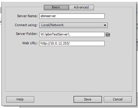

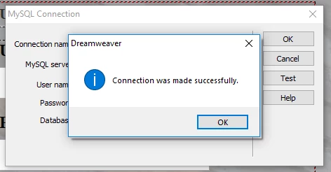

Having Issues with connecting to phpMyAdmin databases in CS6.  I am using an ioSafe 216 NAS that has php5.6, MariaDB 10, and phpMyAdmin that all run through a web station app.  The following are screen shot that show how i can connect to the databases with the IP of the NAS.
However i am not able to bind any of them to Dreamweaver.

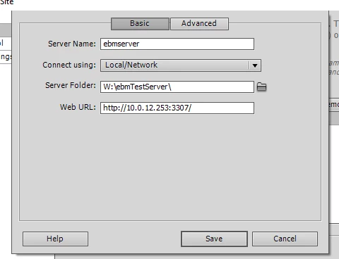

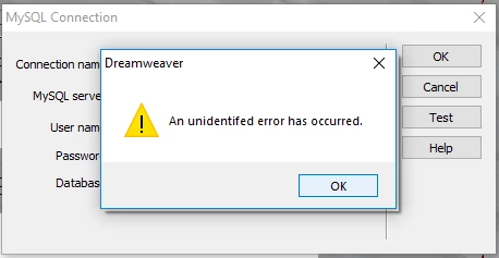

If I change the web url to include the port that MariaDB 10 is using I can get the check mark next to the setup test server to go away, but then I can not connect to the databases anymore.
Any help would greatly be appreciated.
