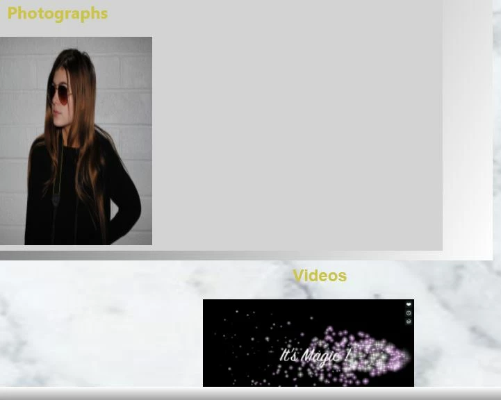

When i use Dream Weaver to write code for my website, in the css file it won't respond to any changes that i make to the padding on any of my images. yesterday i saved it and it looked fine but that was because it wasn't actually responding to the padding changes that i made and it made everything i did wrong. i'm still unable to solve this issue.

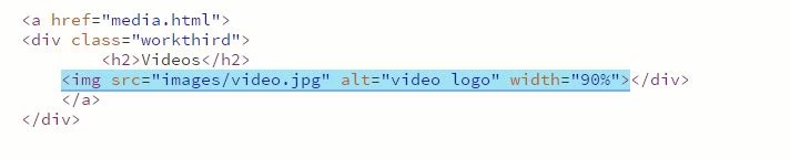

an image is an inline element... so it doesn't have any padding vertically.. at least it doesn't interact with any siblings elements... it just have an horizontal padding... so if you want to add vertical padding to your image, you first will have to cast it to an inline-block, or a block element... depending on the main goal...
then your .wordthird class has some errors in it... you should remove the padding-left and padding-bottom that are negative... negative value are not allowed. The text-decoration should be applied to the anchor element and not to the container
your HTML contains some errors too, your anchor closing tag is above the closing DIV it should be after....

i want to get the image that appears underneath or at the bottom to align next to the image of the girl but i have tried many different ways and it won't go up. any ideas? thanks!

OK, that shouldn't be too terrible, you just have some code that's conflicting with what you're doing that maybe isn't shown in your post.
Could we see the entire code for the page?
