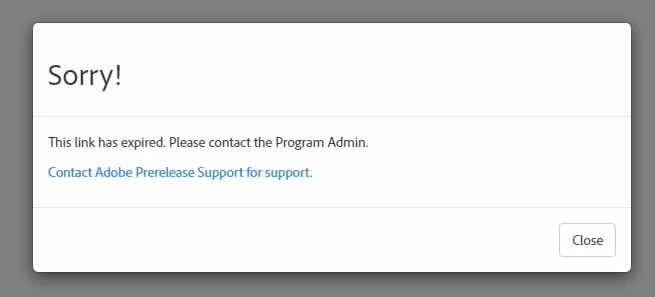

    B i r n o u
    May 3, 2021 2:44 PM UTC
    hello @9420886
    following the link that you gave for prerelease drives directly to this screen... 🙂
    Nayan_Kankariya
    Adobe Employee
    Adobe Employee
    May 3, 2021 3:10 PM UTC
    Hi @B i r n o u ,
    Thanks for trying to access the link. This link will be enabled only for new users and will be broken for existing prerelease users.
    Have a pleasant day!
    Nayan
