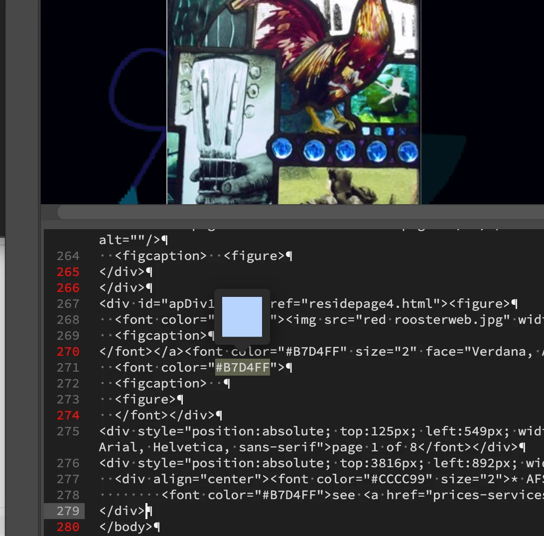

2) the 2nd page is done in these numbered apDiv boxes to hold text or images or both and each has an absolute position( i use this because I'm not a grid person (and I pay for it). There is no red lines in this area but quite a few in the code text below that. I really can't understand the feedbackmessages I get when I move cursor over the reded lines of code. I just wonder if I startd a new version of the page and just put this apDiv code in first and then added text and images in the pre-sized and pre located boxes if that would generate better code and I could watch it as I go and so keep it clean.

<#apDiv10 {
position: absolute;
width: 416px;
height: 223px;
z-index: 7;
left: 85px;
top: 200px;
#apDiv11 {
position:absolute;
width:302px;
height:355px;
z-index:8;
left: 281px;
top: 846px;>
Below is some of the problem stuff

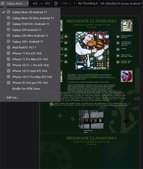

    I'm not sure what devices you're testing on, but the site is unreadably small, and the right side gets cut off completely, on an iPhone 14.
    Swiping side to side to try to see the parts that are cut off, then pinching to zoom in to read are things the general public hates (no, hate is too light a word) despises with every fiber of their being, when they go online with their phones. The old 4:3 design aspect ratio for desktop monitors doesn't work on mobile, refrigerators, 4k+ ultra resolution TVs, etc...

    My system refuses to load the website, hence I cannot comment on the whole site. The comments below refer to the code that you have shown.
    1. There should be no need to use Absolute Position as demonstrated here.
    2. The font element is depricated as demonstrated here.
    3. The proper use of <figure> and <figcaption> is demonstrated here.
    4. Line 266 seems to carry a </div> tag without a corresponding <div> tag.
    There may be other anomolies that I cannot see at this stage. Suffice to say that the website is a complete mess.

    As seen from my desktop device (1680px wide):
    From a handheld mobile device (412px wide), tiny text:
    18 Code validation errors:
    https://validator.w3.org/check?verbose=1&uri=https%3A%2F%2Fwww.brooksideglassworks.com%2F
    4. First impressions matter.  You never get a second chance at a first impression. Your site is not mobile-friendly and it's not accessible for vision impaired users.  This may not seem important but it is.  In 2024, penalizing people for their device or disability won't bring you customers, it will push them away.
