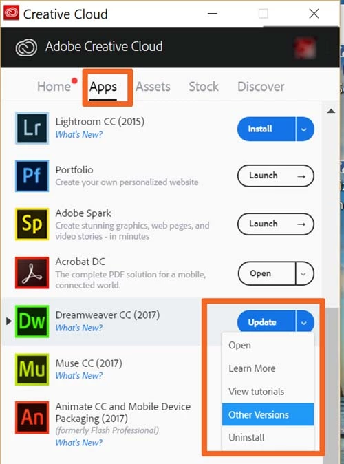

B i r n o u
Oct 15, 2017 6:39 AM UTC
when you click on design or live, don't you have a pop up , as in this video ... 10.15.2017-08.39.14
