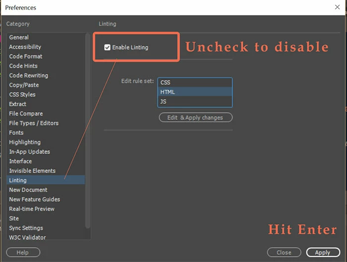

Go to your Preferences.  See screenshot.
