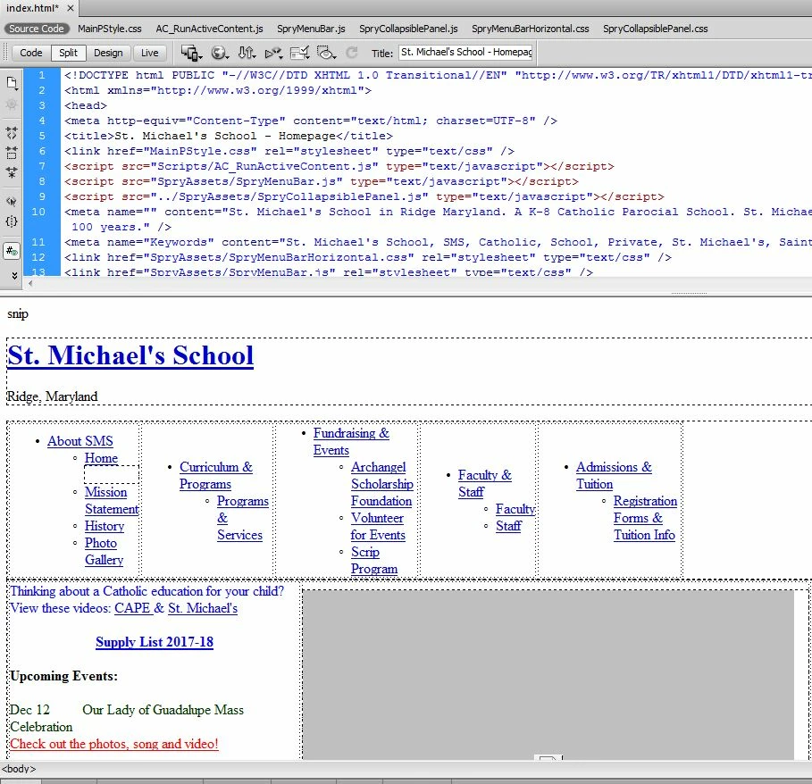

Point taken.  The original structure code for the site was written many years ago and clearly needs to be cleaned up and made more consistent. But would this cause design view in Dreamweaver to suddenly stop working since it worked for years in the past?  Or am I missing some setting in Dreamweaver?
Is that page you posted above from your site's main homepage? (the one at www.yoursite.com?)
If so, the link showing...
../SpryAssets/SpryCollapsiblePanel.js
...would be telling DW to go up one directory level from the site root, which DW can't do. All files must be within the directory set in your Defined Site.
If you're trying to save yourself some duplication by linking to a common file outside of the Site Defintion, DW won't know what to do with it.

meriweather50
Jan 12, 2018 8:13 PM UTC
Yes Jon.  The style sheets, Spry assets and scripts folder had been inadvertently deleted from the local folder. Once they were restored the design view was FIXED!!

Here's a screen shot of the main page for the site, but all the pages show up in design view like this:

Looks un-styled to me.  The paths to your external files are very inconsistent.  Some are pointing to the root folder while others are pointing to sub-folders.  In relation to the document you're working on, where is your MainPStyle.css file?  And where are your Spry Assets?
