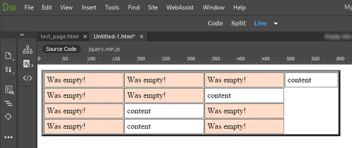

Mar 22, 2017 11:48 PM UTC
I noticed they stripped it out when my comment got approved. They contain the   character.
I came up with some jQuery code that may help you.
Consider this document.  NOTE: I'm using spaces between & n b s p ; to preserve the code in this forum. For this to work, remove the spaces.

<!--jQuery library-->
<script src="https://cdnjs.cloudflare.com/ajax/libs/jquery/1.11.3/jquery.min.js"></script>
<script>
//strip non-breaking spaces from cells
$("td").each(function() {
    var $this = $(this);
    $this.html($this.html().replace(/ /g, ''));
//check for empty cells i.e. <td></td>
$( "td:empty" )
  .text( "Was empty!" )
        //highlight empty cells
  .css( "background", "rgb(255,220,200)" );
</script>
</body>
</html>
In Live View, it looks like this.
Hope this helps.
Nancy

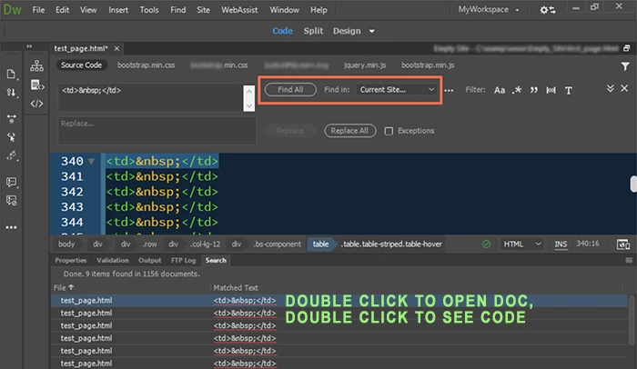

Nancy OShea
Mar 22, 2017 7:19 PM UTC
I agree with Rob that working with static HTML is a bit primitive.  My tables are populated from a database with server-side code.   For this example, I had to create a static HTML page with empty table cells.
Using the latest version of DW CC 2017, Find:
<td> </td>
Current Site
Find ALL
Nancy
