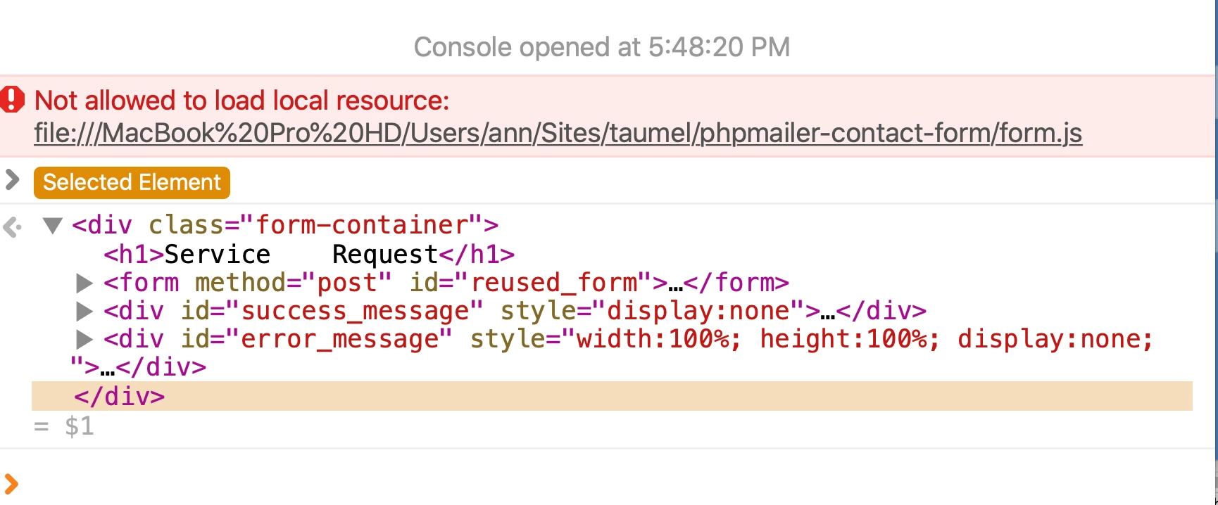

    In Safari, this is what I get from the Inspect Elements/Console when I am supposedly accessing the site across the Internet:
    And Firefox cannot find “phpmailer-contact-form/form.js” although it is present.

    No browser can find it because it's pointing to FILE:/// on your MacBook.  Until your resolve that manually in your code, it won't work from any server.
    To save time, you could change the path to an absolute URL.
    https : // domain / folder / filename/

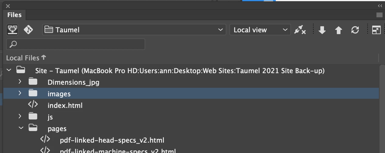

    Oct 13, 2021 7:51 PM UTC
    Nancy;
    I did think that I had set up my DW Site correctly but it seems not?!
    This is what I am seeing in DW:
    The image is very small but the line (which may be the one that counts?) seems to lead back to my MBP?
    Nancy OShea
    Oct 13, 2021 8:05 PM UTC
    When you save a file, paths to asset files should resolve to the correct ones in your site folder.  DW gets confused by code errors though and may not resolve corerctly if there are errors in your code.
    Failing that, remove the old asset and reinsert it.  Save document (Cmd + S).

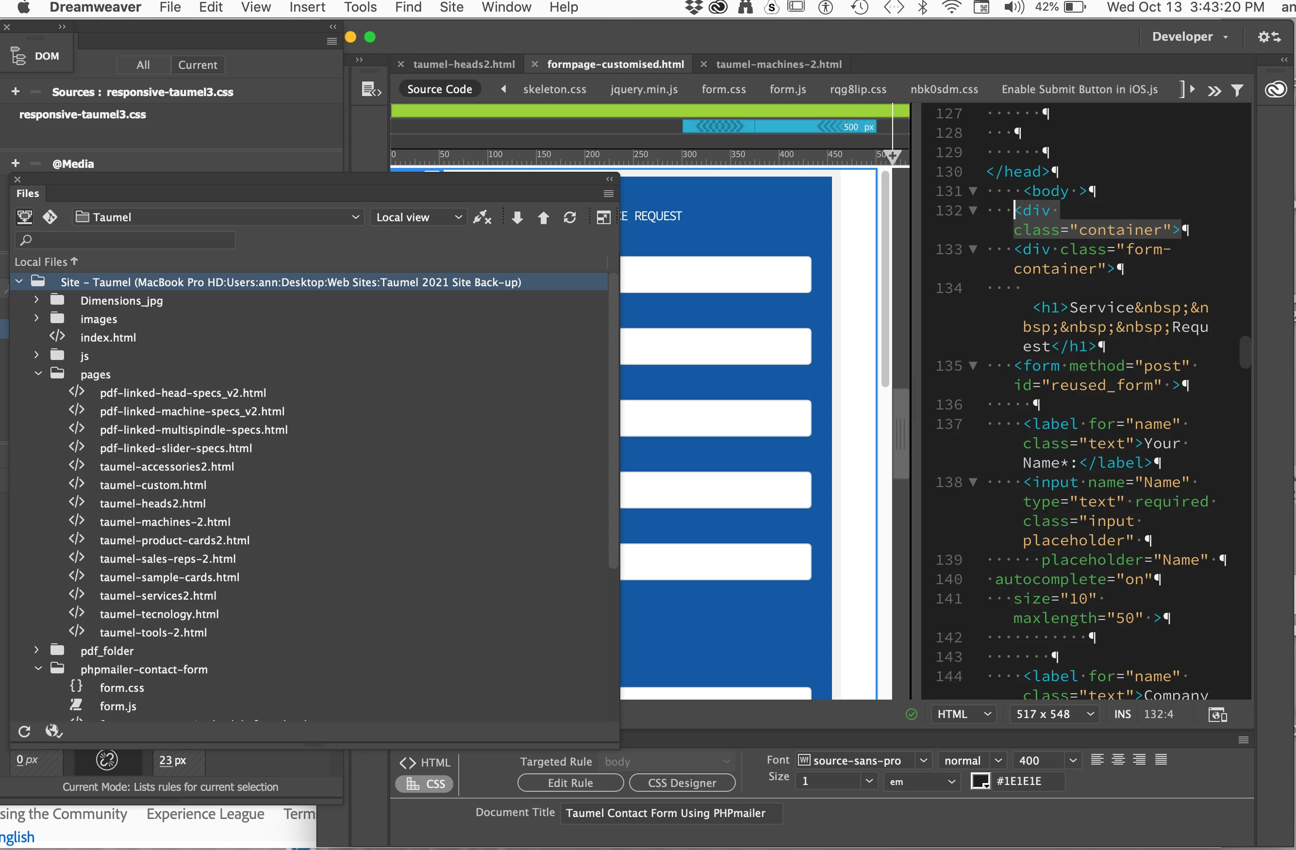

    first question... if you use Dreamweaver, have you created a site, or at least defined a site from Dreamweaver ?
    These errors occur because the file paths shown are files using local sources on the computer. They cannot be loaded by browsers for security reasons, most of the time because they are called by a script.
    Use a relative path either to the document or to the root of the site.
    if you don't understand what I'm saying, don't hesitate to say so, I'll try to be more clear 😉

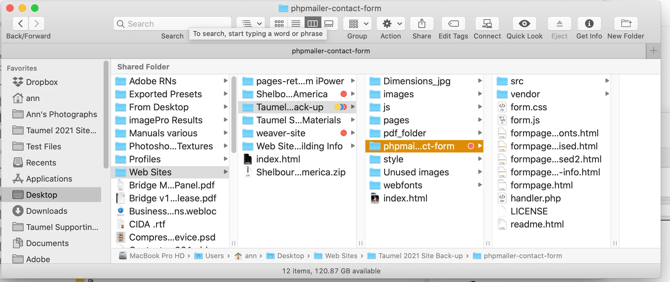

    Oct 13, 2021 7:06 PM UTC
    Birnou:
    Thank you so much for your very quick reponse.
    Yes, I do work within a DW-Site and I thought that the scripts were all safely contained within the Site folder.
    I uploaded the complete Site folder manually to my ISP using Filezilla.
    The strange thing is that the PHPMailer Contact Form was working perfectly but just stopped working?
    This what my Site Folder contains:
    I don't know how to "Use a relative path either to the document or to the root of the site." so I would love to know how to do that!
    B i r n o u
    Oct 13, 2021 7:45 PM UTC
    instead of using such a path
    file:///MacBook%20Pro%20HD/Users/ann/Desktop/Web%20Sites/Shelbourne-America/phpmailer-contact-form/form.css
    I suppose that your web site is located in the folder Shelbourne-America, so
    if you want to define a path relative to the web site, it means relative to the root of the folder where your web site is contained... you use a slash to start the path... so the path will
    now if you want to use a path relative to the document... the starting point wont be the web site root folder, but the document that call (or include) the related file... but this time the path doesn't start at all by a slash. so in the previous exemple, if the hosting file is located at the root folder (sibling of the phpmailer-contact-form, the new path will be
    same as the previous one but without the starting slash
    does this makes sense for you ?
    by the way I see in the current path you use, that you use spaces... space are represented by the %20 string ... it is completly not permited in safe web... so use a - or a _ but not a space
    see... you have thre %20
    anyway if you define corretly the web site in dreamweaver and use relative path (document or website, whatever) those %20 will not appear, because your path will be resume to
    or to
    and there is now spaces in those ones...
