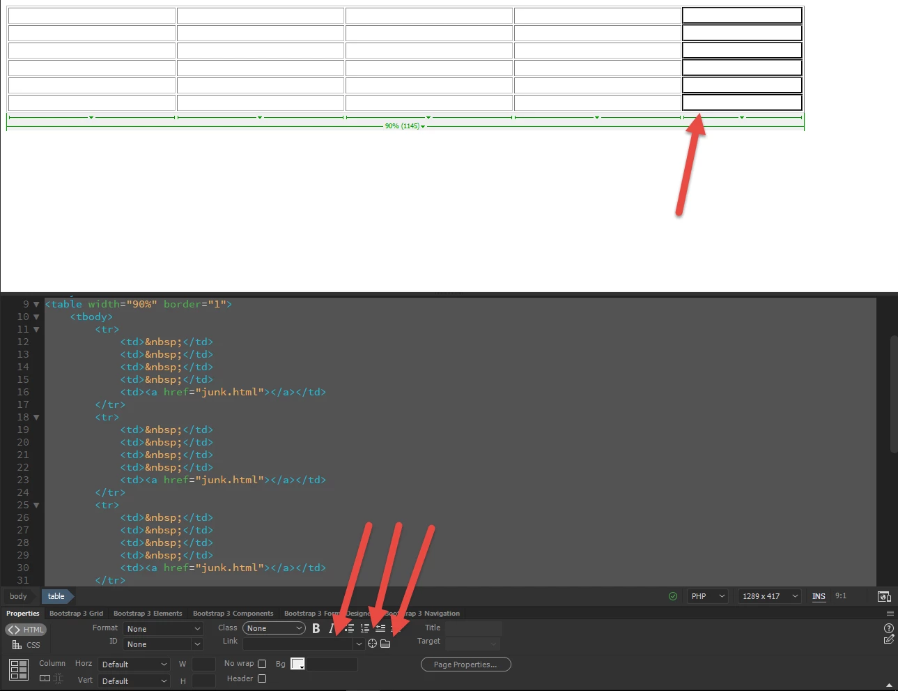

I have a some HTML tables with images in them in code view on the left side and I see the images on the right in design view. Now I would like to click on one of those images to select it, then shift+click on another image a few rows down so that those 2 and all the images in between are selected. By doing so I would then be able to add a link (the same link) to all those images in one shot. Do I have to set this up somewhere in the new dreamweaver?

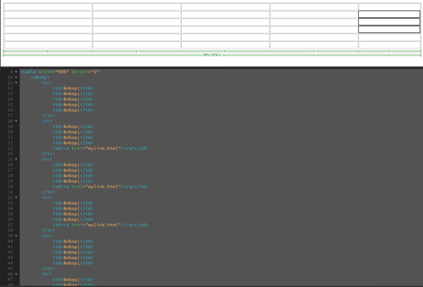

I think I see what's going on now and have figured out how to work around this. What I'm use to doing is R+Clicking on one image, then holding down SHIFT while R+Clicking on another image to select all rows in that range. This no longer works - at least not for me. Turns out, all I need to do is R+Click a 2nd time on the 2nd image, then all the rows in that range will be selected. Also worth noting: I can't Double R+Click while holding down SHIFT on the second image; I actually need to pause before the second click.

December 14, 2016
In reference to my original question - clicking on one image, then another to select those table rows and all in between. Most of the time it doesn't work. Then there are instances where I can only do it if I first select an image further down then select an image in a row above it, but not if I select an image in a lower row as my second image. Usually what happens when I select the second image is that that will be the only row that remains selected, instead of the desired result which is to have all of the images selected.

December 8, 2016
I did not realise that the 'new' Dreamweaver was any different to the 'old' Dreamweaver in this regard. All you need to do is to highlight the column and link using your preferred method

December 8, 2016
Did you read my question? I'm not asking about highlighting an entire column. I'm asking about highlighting subsequent rows within a column.
BenPleysier
December 8, 2016
I did read your question and the same principle applies. I have unmarked my answer as being 'answered' until you have found the solution. Please see below
