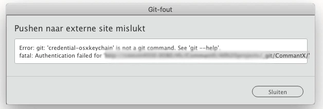

After updating to Dreamweaver 2020 I can't connect with our GIT environment anymore. It keeps popping up with this: credential-osxkeychain is not a git command.
I've tried removing the keychain, renewing the user/pw, but it doesnt seem to store them anymore.

At first I parked this issue but because I recently did a complete reinstall of my Macbook pro, I tried to re-configure GIT.
What have i done:
I followed the instructions at: https://helpx.adobe.com/nl/dreamweaver/using/git-support.html
- installed GIT
- tried to connect my DW site to a GIT environment.
- upon saving it popups with the error shown above
At first I found that there are 2 GIT installs (one pre-installed from Apple v2.21 and the one I just installed v2.23).
I added the path to the newly installed GIT (in /usr/local/git/bin) to /etc/paths (at the top).
Still it won't connect to my GIT environment.

credential.helper=osxkeychain
Doe you have any suggestions?

I guess it's a Catalina related issue... other Git cleints hav ethe same problem. I'll have to check further.
