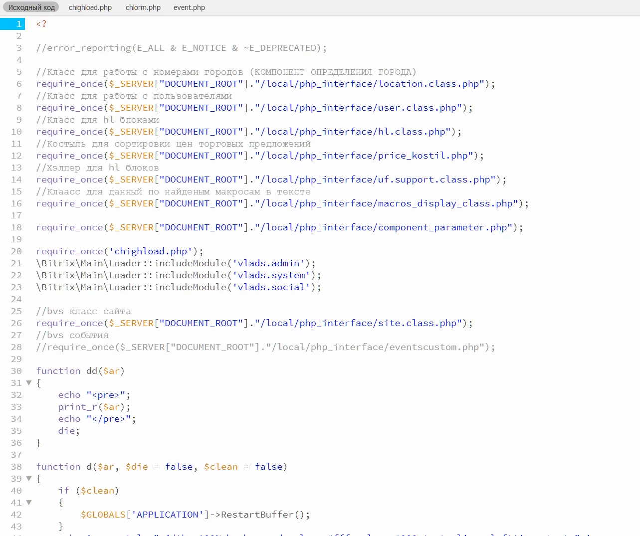

 I will write through a translator. Adobe Dreamveaver breaks PHP code in many places when formatting. How to COMPLETELY disable PHP code formatting, but leave HTML formatting ???
And this is just what I noticed !!! I tried to set it up via https://helpx.adobe.com/en/dreamweaver/using/format-css-code.html But it didn't work for me. How to disable incorrect php formatting? I used to have an old DREAMVEAVER 2015 and everything worked fine on it

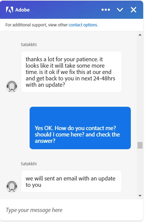

    They are deceiving me. I waited 48 hours, they didn't even try to solve my problem. Then they offered to connect to the server via SFTP! What does server connection and code formatting have to do? I have been using this program for over 10 years, it has completely deteriorated, I will demand a refund of my funds. They promise, then all over again, they apparently do not even understand programming and do not see the problem point-blank. How can people not versed in code solve such problems and make such programs?
    Here's what they answered me a week ago:
    Here's what they answer me today:
    This is complete nonsense. I cannot spend so much of my time solving problems with the program.

    I have the latest licensed version installed. Thanks for the answers, I want to completely disable PHP formatting, leaving only HTML and CSS formatting. Regardless of the type of file, since my code may be mixed.

    I tried adjusting the formatting, it keeps messing up my code anyway. And how should I be?

    What kind of document is it?
    Jul 22, 2020 11:17 PM UTC
    Are you talking about unwanted spacing or is it completely breaking your code?
    What version of Dreamweaver are you using? More recent versions of Dreamweaver had fixed a lot of issues with PHP formatting.
    Dreamweaver uses JS Beautify and a PHP plugin, on Wndows for example look here: C:\Program Files\Adobe\Adobe Dreamweaver 2020\www\extensions\default\BracketsDWBeautify\default.jsbeautifyrc - at the bottom see the PHP options.
    Make a backup before editing, you can also put .jsbeautifyrc file in you project root with your custom settings.
