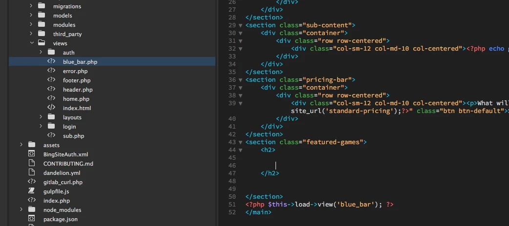

Every single working day, all day long the in the dreamweaver editor it freezes in the middle of editing or writing code. I will be typing away. And then boom. Frozen. I have to wait for it to catch up or do what ever it is doing.  Today I finally decided to take the time out of working and mention here.

see image the cursor is where I was typing when this happened. Also the hidden characters are gone again so I can see the tabs and make sure there are no spaces. The hidden characters come and go on their own.

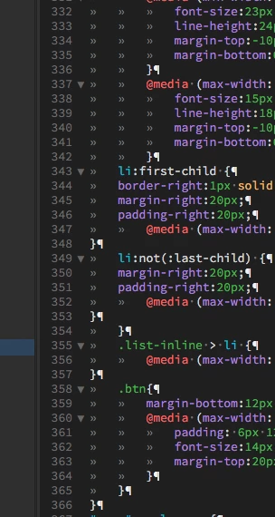

but if I click my css tab at the top i see tabs on that page. but I never know when I'll be able to see tabs. they come and go. Along with the FREEZING symptom.
