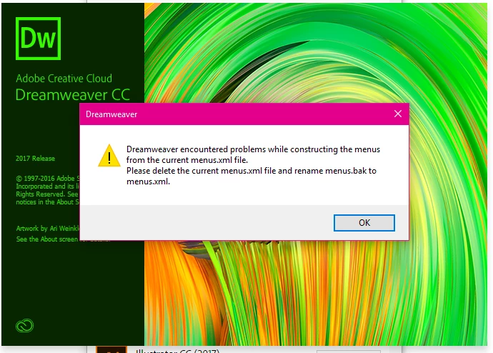

Dreamweaver CC 2017 won't open due to error how do I fix this?
This just started happening yesterday. I tried the "fix" suggested here but it doesn't work, unless I have done it incorrectly, which is possible.
I have uninstalled and reinstalled several times and nothing is working.
When I click on OK it just closes down.

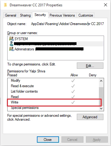

YalpiCorrect answer
Dec 21, 2016 8:37 AM UTC
The error occurs when Dreamweaver does not have write access to %appdata%\Adobe\Dreamweaver CC 2017
Can you please check if the current logged in user has Write access to the folder. If not, kindly add the permission and then try launching Dreamweaver.

Can you also have a look at this doc The menus.xml file in Dreamweaver  and let me know if it helped?
Dec 20, 2016 7:48 PM UTC
Not exactly how this link helps anyone with this issue.  For me the issue arose with a recent update.  Dreamweaver worked fine before hand, now it doesn't.  The menus.xml was never changed, appears to be in the right place and the backup version is the same as the original.  So error continues after deletion of menus.xml and renaming menus.bacst
Also the error will leave an instance of Dreamweaver 2017 running in the Windows Task manager.  Each attempt to start Dreamweaver with this error results in multiple instances of Dreamweaver being listed in memory.  Have tried shutting down with each error and correction, however, still no solution.
Is there just a default menus.xml file somewhere that can be downloaded from Adobe that would just be a 'stock' file that can be installed to overcome this issue?  I had been using the default menus.xml can't an original default copy be made available?
Also some threads have suggested deleting the Configuration files in the Win10 User's Roaming section, however, upon inspection the Dreamweaver CC 2017 folder in this area is empty.
Am awaiting call back from Adobe tech staff as I write.......
YalpiCorrect answer
John Waller
Nov 15, 2016 1:57 AM UTC
Have you tried?
Dreamweaver menus.xml
What else have you already tried exactly? Got links?
