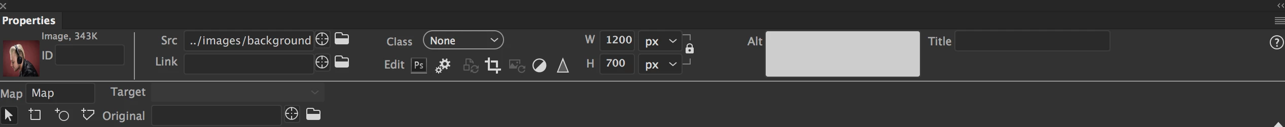

HI Everyone,
I am in need of some help with the hotspot tool. I have created a document and want to put hotspots on my image. However whenever I click and drag to create the hotspot, it doesn't appear and the properties panel disappears with it. This happens everytime. Any clues as to why this isn't working would be great. I have googled so much trying to find the answer and nothing is helping me.
Thanks
When I am trying to create the hotspot- p.s. I have typed in the alternate text and the link and target and it still doesn't allow me to draw the hotspot.
After my attempt the properties panel goes to this state.

I had the same problem. I found the problem to be that the Inspector Panel wasn't fully open. You need to select the image and double click on the Inspector Panel to fully open it where you will see the Hotspot icons. This didn't open it for me at first, not sure what I do different now but it works fine now.
I hope that helps. JT.

One other tip:  If you are in "live" view, you won't see the hot spot icons in properties. If you switch to "design" view, they become visible.
Dec 23, 2019 1:07 AM UTC
that's the ticket

The reason that I pointed to the article is because you are probably not using the correct procedure.
With an image in front of me in Design view, I click on the icon that represents the shape of the hotspot, I then click on the image and while holding down the left mouse button, I drag the hotspot onto the image. After that I will name and place a link on the hotspot. If I need to reposition or alter the size or shape, I can do this as well.
