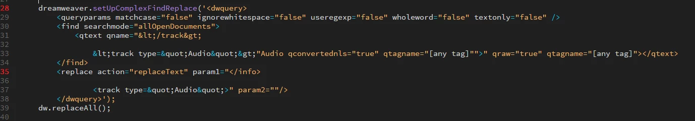

bvherzogAuthor
Jul 11, 2017 1:31 PM UTC
The DWR was like so (it didn't stay in the above post):
