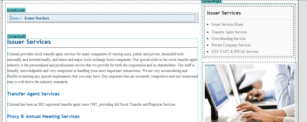

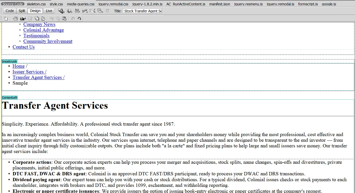

Dreamweaver design view:  formatting not showing, only text and links on nested template pages and htm pages, but shows on main template pages.  Need help ASAP.  See screen shots below.  The website is www.colonialstock.com.  Let me know if you see anything in the code, doing it on all pages
This is the ERROR: Here is the design view for my nested template and normal html pages.  The design is not showing full formatting etc even though style sheet is attached.
This is CORRECT: Here is the design view for my template page.  Shows up correct.

Well, I figured out how to fix my display problem. I opened the template and made a change to an editable region (which won't affect the template regions). Then I saved the template and updated all the files. It would be nice to figure out what I did to cause this to happen.

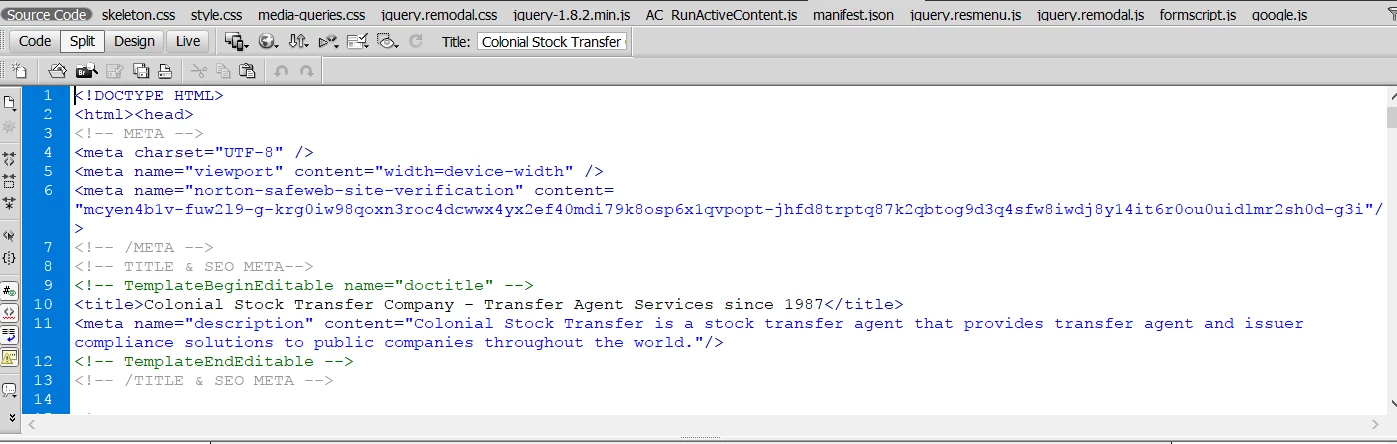

No, all of my dwt main template and nested template files are still in the Templates folder and the folder hasn't been renamed.  How could I check this?  Whenever I update the template pages they still flow correctly to the rest of the site.   The design isn't working in design view for the main template page and not my nested templates or regular pages.  Something tells me it has to do with nested templates.
All of my code is live online you can look at it.  I don't want to post the code here as it could be a myriad of different things from within the code that are causing this.
Here is the nested code:
Here is the main template code:

There are a few coding errors as shown in Showing results for https://www.colonialstock.com/ - Nu Html Checker. These do not cause the problem that you are seeing.
The problem is Design view which has not been updated since !pre-CSS days. If you want to see what the site looks like, in later versions of DW, go to Live view, in your version check in a browser.
