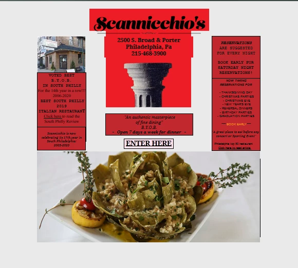

    Yes I saw it but when I change it it does not change my background
    Open index.css file and edit code manually.
    Change background-color to #EAEAEA.
    Save changes (Ctrl/Cmd + S).
    Upload file to server and refresh your browser.
    It should look like this:
    The address box is getting it's red background-color another stylesheet called master_a-master.css file.
    #u80-8 {
    background-color: #ED1C24;
    I wasn't exagerating when I said Muse code is horrible.
