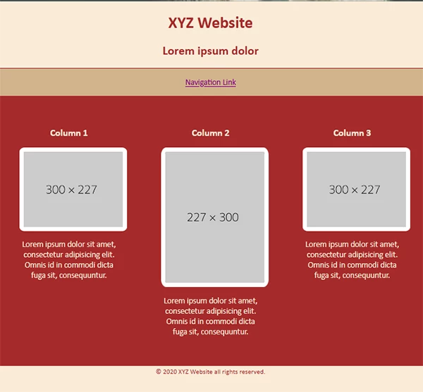

    Simple CSS Flexbox layout -- responsive, no floats & no tables.
    Copy & paste this into a new, blank document.
    <!doctype html>
    <html lang="en">
    <head>
    <meta charset="utf-8">
    <title>Flexbox Columns</title>
    <meta http-equiv="X-UA-Compatible" content="IE=edge">
    <meta name="viewport" content="width=device-width, initial-scale=1">
    <style>
    body {
    margin: 0;
    padding: 0;
    background:antiquewhite;
    color:brown;
    text-align: center;
    nav {
    background-color:tan;
    padding:2%;
    border-top:1px solid brown;
    nav a {color:purple;}
    /* Mobile first*/
    .flexbox-container {
    display: flex;
    flex-direction: column;
    /* Tablets, Desktops*/
    @media only screen and (min-width: 630px) {
    flex-direction: row;
    justify-content: space-evenly;
    /* All devices */
    .flexbox-container > div {
    flex-grow: 1;
    padding: 5%;
    background-color:brown;
    color:antiquewhite;
    img {
    max-width: 100%;
    height: auto;
    display: block;
    vertical-align: baseline;
    margin: 0 auto;
    border:10px solid white;
    border-radius: 5%;
    </style>
    </head>
    <body>
    <header>
    <h1>XYZ Website</h1>
    <h2>Lorem ipsum dolor</h2>
    </header>
    <nav><a href="#">Navigation Link</a></nav>
    <main class="flexbox-container">
    <div>
    <h3>Column 1</h3>
    <img src="https://dummyimage.com/300x227" alt="placeholder">
    <p>Lorem ipsum dolor sit amet, consectetur adipisicing elit. Omnis id in commodi dicta fuga sit, consequuntur.</p>
    </div>
    <div>
    <h3>Column 2</h3>
    <img src="https://dummyimage.com/227x300" alt="placeholder">
    </div>
    <div>
    <h3>Column 3</h3>
    </div>
    </main><!--/flex-container-->
    <footer> <small>© 2020 XYZ Website all rights reserved.</small>
    </footer>
    </body>
    </html>
    Post back if you have any questions.

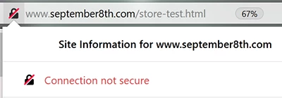

    #4 Your site is on a non-secure HTTP server.  Google is penalizing you for that, too.
    Ask your host about SSL/TLS certificates.  Or investigate free certs from Let's Encrypt or Cloudflare.  These days, there's no excuse for not being on a secure server especially if you're doing e-commerce because potential customers are less inclined to purchase from non-secure sites.
