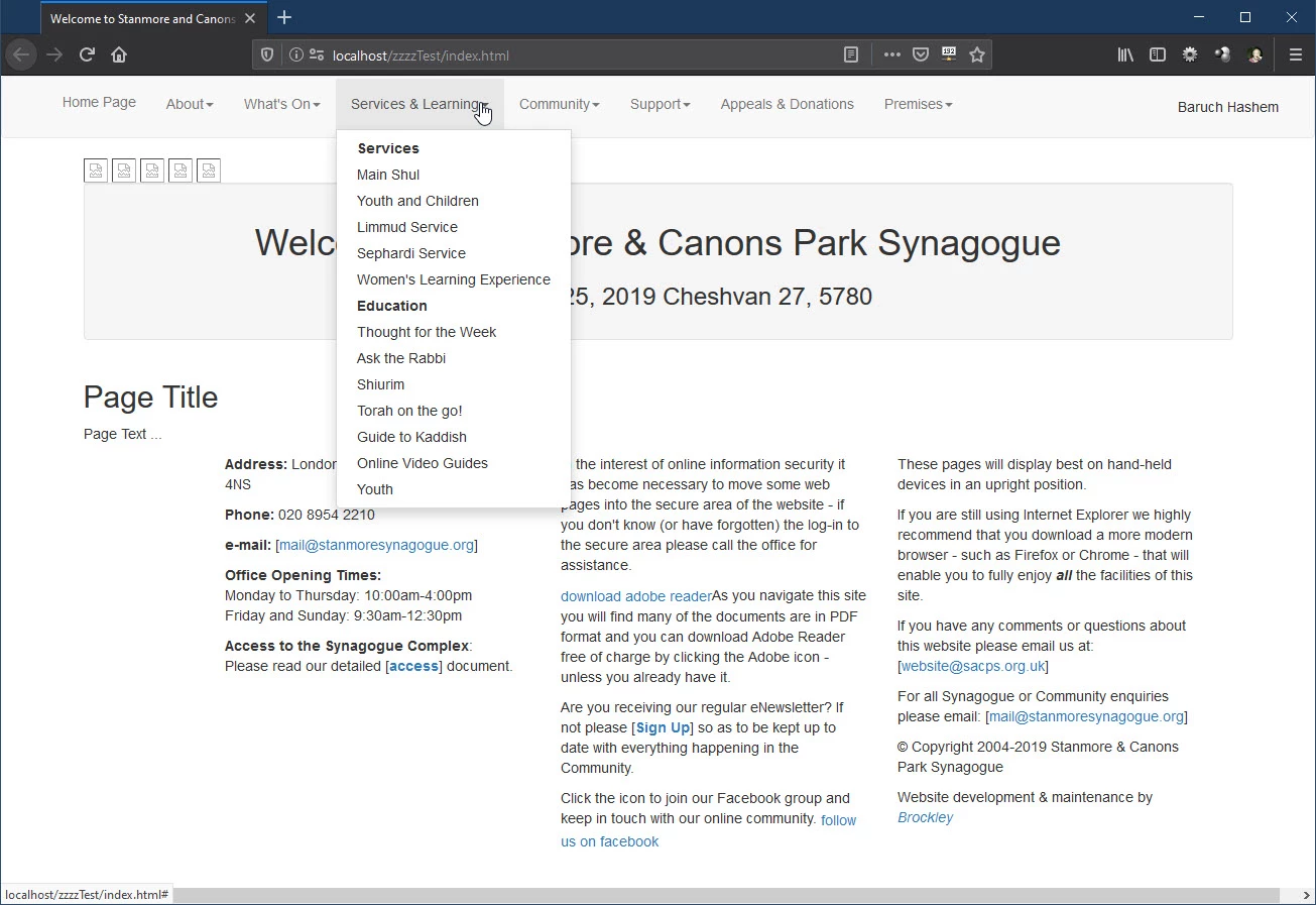

I have just created a child page in an effort to replicate the problem, however, without success as can be seen from the following screen shot.
This is the relevant code:
<!-- InstanceBeginEditable name="head" -->
<meta name="viewport" content="width=device-width, initial-scale=1.0">
<!-- InstanceEndEditable -->
Do you mind, in stanmore_responsive.dwt, moving the above 3 lines to  just belowthe folowing 3 lines

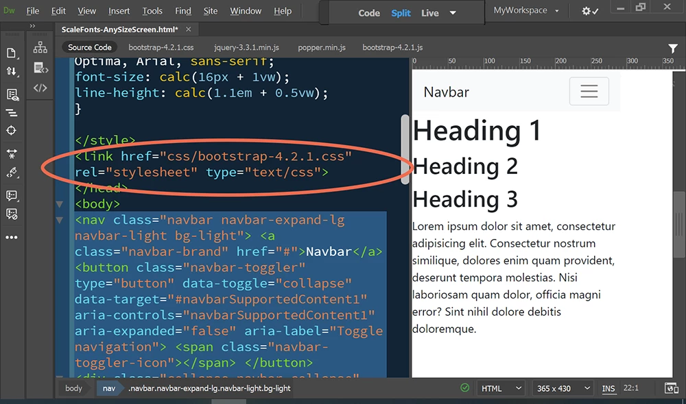

Ordinarily DW does not add Bootstrap code to documents unless you insert a Bootstrap component.

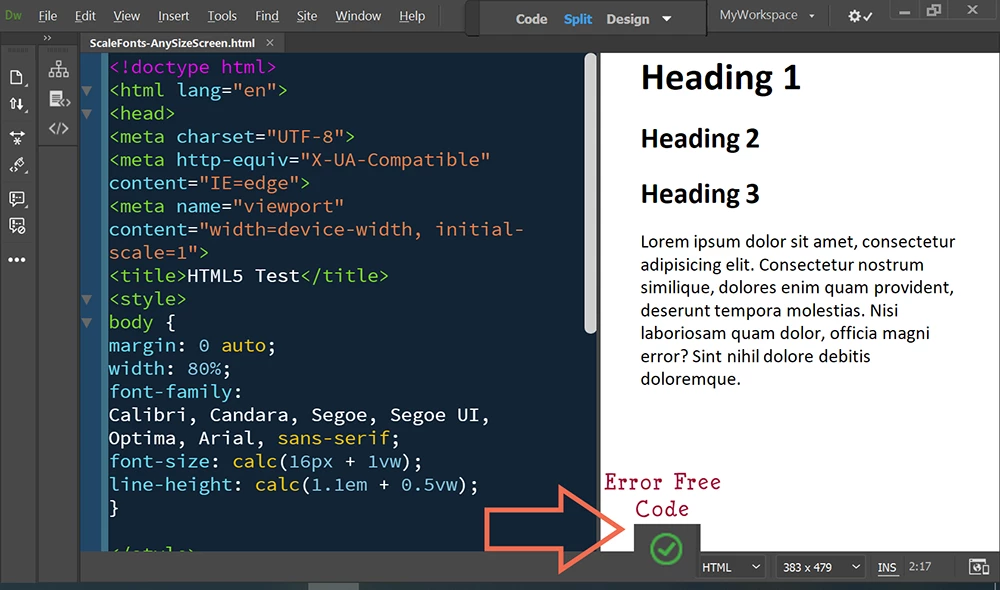

In this example, my error-free code does not contain any Bootstrap.  I emphasize error-free code because DW can go bonkers when it sees critical code errors.   So make sure you're working with clean code.
After inserting a Bootstrap navbar, DW adds Bootstrap CSS to my <head> tag

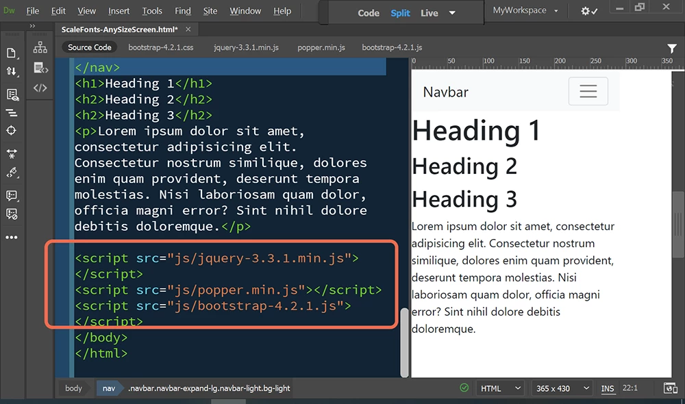

And the 3 amigos -- jQuery core library, popper.js and Bootstrap.js are added to the end of my document, just before the closing </body> tag.
Incidentally, you can change the Bootstrap version from your site definition settings.  Site > Manage Sites > click on the pencil icon > Advanced settings > Bootstrap.
