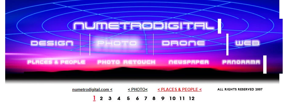

Dreamweaver MX spreading some cells when inserting an image in a cell
I am using Dreamweaver MX.  Sometimes when I add an image into a cell that is the correct size for the cell, it spreads some of my other cells horizontally and leaves white spots between some of my cells when I preview in my browser.  I have Cellpad and Cellspace set at zero.  I am an experienced Dreamweaver user.  Thank you for any help.

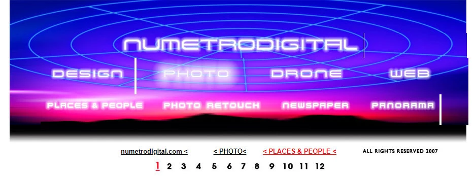

    Oct 9, 2026 7:03 PM UTC
    Hi again. This screenshot shows my most recent work, with everything in place and the pieces slightly less separated.
    Thanks for your input, and I look forward to your next reply.
    Thank you, Tracy
    Oct 9, 2026 5:03 PM UTC
    Thank you for your answer.  Where do I insert the 1x1 pixel gif file to do what you are telling me about?  I am not able to provide a link right now because this Dreamweaver file is not online yet and the domain for my website is parked at GoDaddy.com.  When I click to insert a file in this reply it will not let me attach a Dreamweaver file.  I could attach a screenshot of this webpage to show you how it looks when when some of the cells have white spaces between them,  but that probably wouldn’t be much help… but I will anyway.
    I have the same problems with some of the cells spreading horizontally leaving white spaces between them when I delete an empty cell or when I try to make a new cell with the cell drawing tool.
    Thank you,
    Tracy

    Oct 14, 2026 6:10 PM UTC
    Update:  I got this webpage to finally work… all is smooth and no white spots.  The solution now seems obvious to me for a fix.  In the 3 or 4 cells on this page that would not adjust to make them one pixel smaller horizontally to fit the image that goes there, I finally figured it out… make the images within the problem cells one pixel larger horizontally to fit the cell.  It works.
