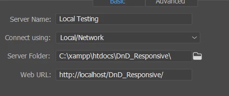

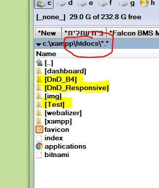

karpiyonAuthor
Dec 19, 2018 5:35 AM UTC
Are you sure this is how it works?
I have 3 testing servers under xampp/htdocs.  i created the folders DnD_B4, DnD_Responsive & TEST myself and specified it in DW
i can't move all of them under the same root?
or am i doing something wrong when specifying the path in DW?
