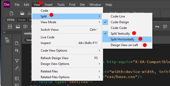

    Dec 14, 2020 2:23 PM UTC
    The setting is under View > Split...
    If DW isn't remembering the setting you have chosen there, you will need to restore your preferences file by following the instructions here: https://helpx.adobe.com/dreamweaver/kb/restore-preferences-dreamweaver.html
