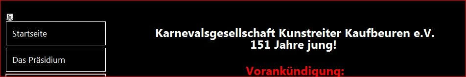

Hello everyone,
one of my difficulties to use DW CC 2017 is the different way "includes" are illustrated. Here my problem:
1. Version 2017 (Entwurf Standard >>> translated: Draft Standard?)
Instead of the original includes I see "php"
2. Version 2017 (Live View >>> translated: Developer?)
I see neither php nor the includes.
3. Version 2015:
The two includes are visible (menu and the textlines "Karnevalsgesellschaft ...)
Will there be a chance to get the latter kind of style so too in DW 2017?
Many thanks in advance for your support.

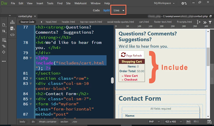

    Mar 16, 2017 5:20 PM UTC
    Design View or Live View?  As shown below, I can see PHP includes displayed in Live View with CC 2017.0.1.  My local testing server is WAMP.
    Nancy

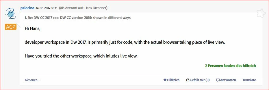

    pziecina
    Mar 16, 2017 5:11 PM UTC
    Hi Hans,
    developer workspace in Dw 2017, is primarily just for code, with the actual browser taking place of live view.
    Have you tried the other workspace, which inludes live view.
