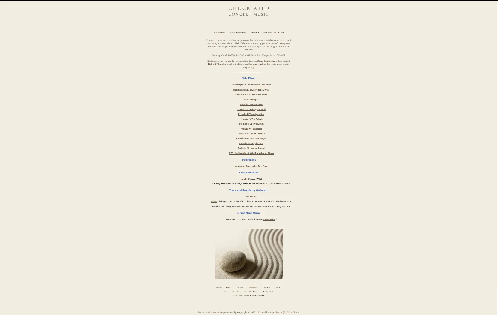

On the Concert Music page, I'm having trouble centering text within a div/wrapper. As you scroll down the page, you'll notice that text below each blue subtitle isn't properly centered. I'm attaching a screen shot to help illustrate this issue (I added the red arrows).
It's driving me bonkers. There's probably a simple fix somewhere in the code.

It's actually the browser default padding of the <ul> tag that's causing the misalignment.
You can add this to the end of your stylesheet to fix it...
ul {padding:0;}

Thanks much, Jon. Problem solved! A simple, elegant solution.
I should have remembered your snippet, but my tired old brain shuts down after hours of rummaging through miles of code.
Everything on the Concert Music page is now properly centered, just like my client wants it. You are hereby awarded 5 gold stars from Art101 Global Command. Thanks again.
