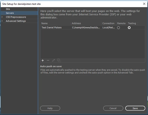

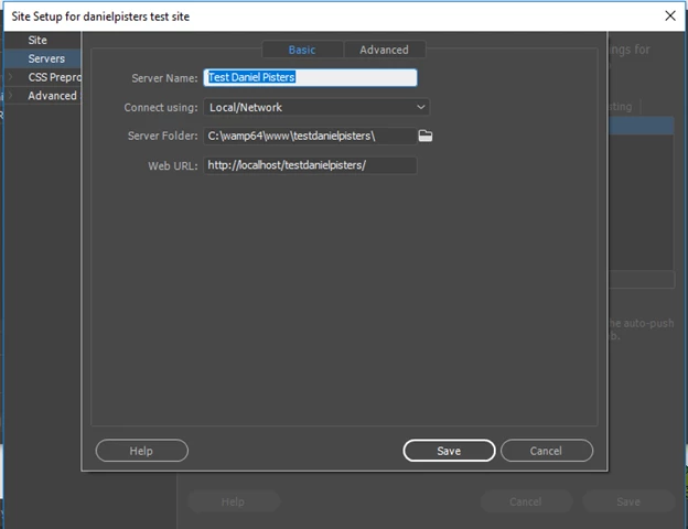

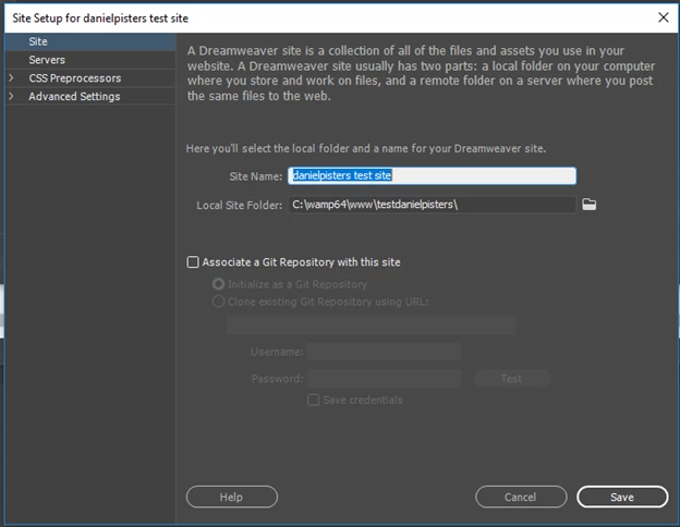

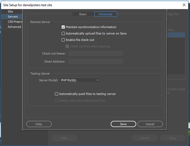

SETUP OF TESTING SERVER IN DW CC
I scrupulously followed the indications of David powers in his article Setting Up a Local Testing Server in Dreamweaver CS5 (https://www.adobe.com/devnet/archive/dreamweaver/articles/setup_testing_server.html
as shown in the screenshots below:
1)
2)
3)
4)
5)
Save again.

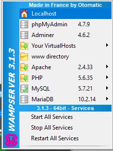

As for the WampServer, this is much better
The icon on the right side of the screen is green, which means that all services are active.
If I click on Localhost, I get well http://localhost to which I add/testdanielpisters and it understands that it should open index. PHP but if I click on the menu it does not understand that it should open creative. PHP For example in same directory. I then have to specify http://localhost/testdanielpisters/creative.php and from it http://localhost/testdanielpisters/includes/cerativePouhons.html for example. But I think that by looking for a little, I will find the parameter to define. This is all new to me.

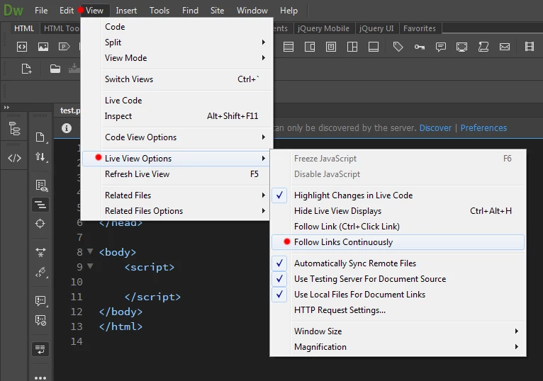

Live View won't follow links unless you set DW to follow links continuously in Live. The setting is under View > Live View Options > Follow Links Continuously...
