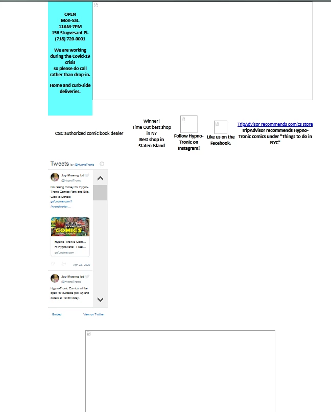

DWmx Website does not vertical scroll on any browser
Site I am trying to build using my old DreamWeaver MX scrolls fine in design tool but not on any browser.
I tried several ways to scroll vertically but none are effectual.
The age of the website building tool (DreamWeaver MX) I'm using may tip you off as to how much a noob I am, but I've never seen this before.

    By the looks of things, the missing scrollbars are the very least of your worries.  And the 55 code validation errors don't help matters.
    http://validator.w3.org/check?verbose=1&uri=https%3A%2F%2Fmudshark.com%2Fhypno%2Findex.htm
    Maybe it's time to hire an experienced developer or switch to a modern DIY site building platform like Wix, Squarespace, Webflow or WordPress where no coding skills are needed.
    See screenshot.
