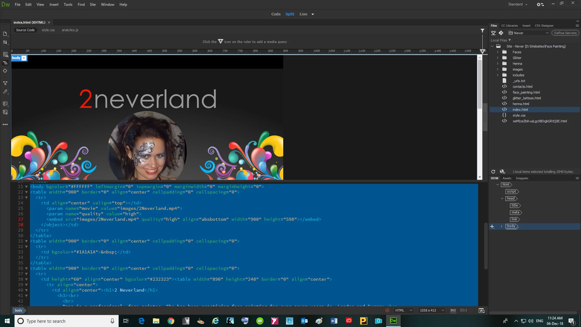

Hi everyone,
Thank you all for your help. Nancy's idea worked. I created a new site and directed it to the old one which sorted out the main problem, thank's a lot.
The mp4 file seems to be sorted as well with a small issue, it went to the left an didn't stay in the centre for some reason.
I am attaching a screenshot of the source code, hope to find out where is my mistake.
Thank you all in advance for your support.
Magdi
Nancy OShea
Dec 4, 2018 7:09 PM UTC
Table based layouts  are a relic from the pre-mobile & tablet device era.  Today we build sites responsively to work on all devices.  Tables are for tabular data only,   Also, the ALIGN attribute is obsolete and has been for quite a while.
