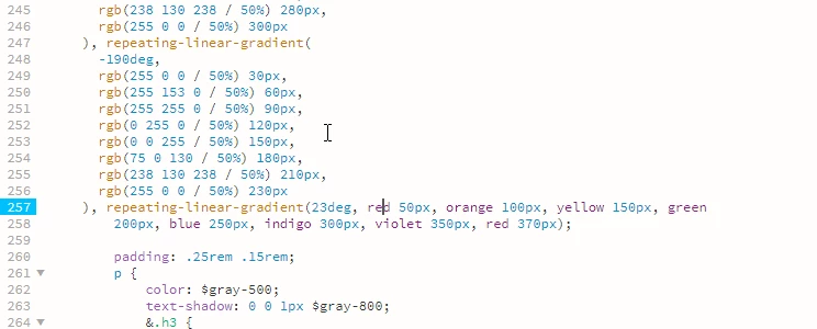

Editor crashed when css gets a bit complex
Lates version of DW on updated Windows 11.
See the cursor, when it is positioned there the editor crashes. Every time.

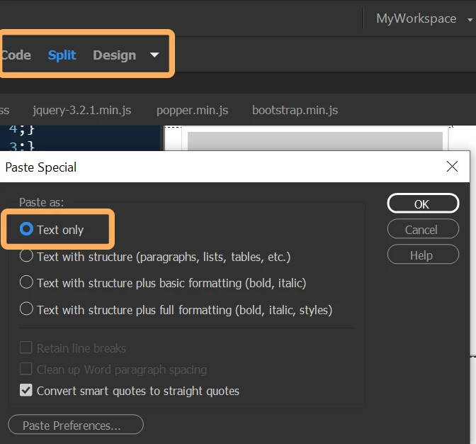

Nancy OShea
Jan 21, 2024 9:58 PM UTC
1. There should be no line breaks inside a continuous code string.
2. Use the correct line break for your server.
3. When copying & pasting,  use Edit > Paste Special > Text Only to remove unwanted formatting from code.

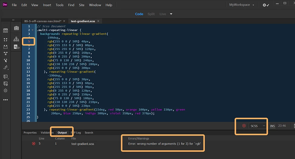

Jan 19, 2024 7:45 PM UTC
quote
To resolve the error, I inserted commas between values like this.
rgb(255, 0, 0) 50% 40px
By @Nancy OShea
In fact, it's DW that's in trouble: the fact that it hasn't been updated means that its code corrector doesn't integrate the higher levels of CSS.
The way @vincnet is coded is correct, there's no need to resort exclusively to comma-based syntax to describe a color in rgb or rgba, https://docs.w3cub.com/css/color_value/rgba.html

vincnetAuthor
Jan 18, 2024 9:57 PM UTC
Dear Nancy,
Are you wrinting this reply to me or for the whole community? Thank you for your suggestions, but it is not an answer to my bug report.
I know what SCSS is. I use it for almost a decade. And in my case it is compiled to CSS on the server.
I use DW as editor for years now to edit the SCSS files, without issues.
What happens is simple: I copied the lines of code into my SCSS file and when I clicked into the lines of code, the editor freezes. Every time. I suggest you do the same to reproduce the issue. No compiling, just copy paste it and see what happens if you try to chenge the word "red" for instance.
I hope your response will be more to the point now.
Nancy OShea
Jan 19, 2024 12:38 AM UTC
I am unable to reproduce the lock-up problem on my end.  But I see a code error reported on line 5.
OUTPUT PANEL:
ERROR: Wrong number of arguments (1 for 3) for 'rgb'.

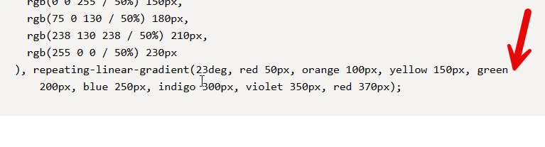

Jan 18, 2024 9:12 AM UTC
We can see on your screen grab that the declaration containing repeating-linear-gradient seems to be missing a closing curly brace, just after the declaration of padding.

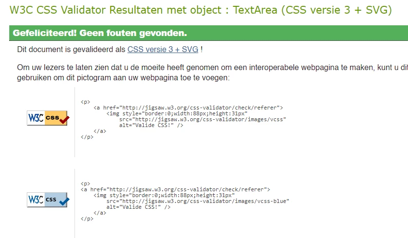

Jan 18, 2024 8:37 AM UTC
Thank you for your reaction.
It is a CSS file (SCSS) and the code is validated. It is an example from https://developer.mozilla.org/en-US/docs/Web/CSS/CSS_images/Using_CSS_gradients (see code below) and validated on https://jigsaw.w3.org/css-validator/validator (see image below).
But even if it's not valid CSS, the editor should not crash.

Nancy OShea
Jan 17, 2024 11:29 PM UTC
What kind of file is this?
I can't tell much from your screenshot.
If this is a CSS file, validate and fix reported errors:
