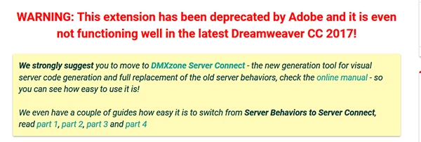

    Deprecaetd Server Behavior Panels can be found below but note the warnings.  This extension's code will not work with PHP 7.
    https://www.dmxzone.com/go/21842/enable-server-behaviors-and-data-bindings-panel-support-for-dreamweaver-cc
    3rd party extensions to replace the one above.

    The server extensions documentation can be found here: Dreamweaver server behaviors, bindings, and databases​ . However, they are  out of date and I would strongly recommend looking into 3rd party alternatives.
