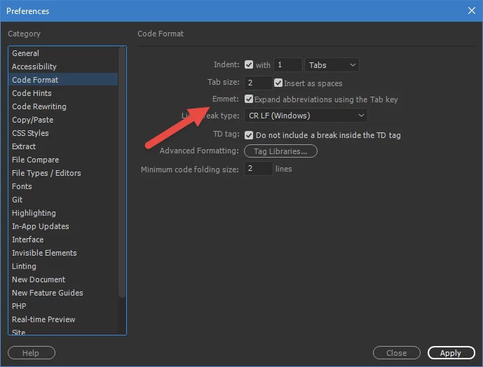

There is a feature to turn Emmet off as per
But this will not help with your problem.

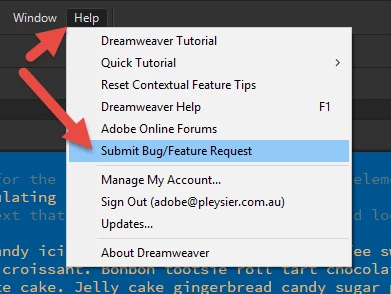

I have not been able to supply a solution, hence I would suggest to report the problem by going to
