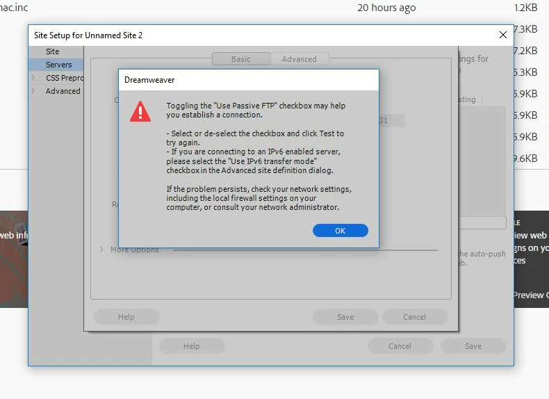

We also have testing sites for these live sites, but every time I try set up a site for them it gives me an error message. The connection details I used for setting these up are the same that I am using when working with FileZilla (and it works fine there). The reason I need to get these sites set up asap is because I need to edit main template files, which then need to update other pages.
Please see the image of the error message attached. We have tried everything , but no success.

The issue has been fixed. It was something to do with Firewall settings.

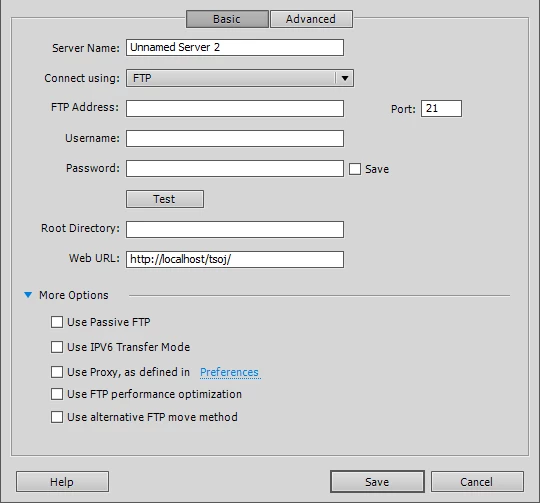

Have you tried changing the Use Passive FTP, FTP Performance Optimization and IPV6 Transfer settings under the More Options section yet?
