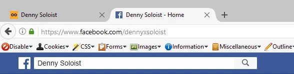

    When you view the site that you are trying to link to, you will see the full URL in the address bar as per
    This means that, instead of
