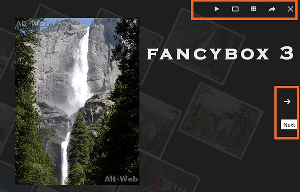

Nancy OShea
Dec 7, 2017 7:30 PM UTC
If you don't see the toolbar across the top, that means your Fancybox function script is broken.  It's not invoking at all.
Below is a working demo with latest Fancybox 3.   View source to see the code.
Alt-Web Demo : Dynamic Photo Gallery with Bootstrap, PHP & Fancybox
Nancy
