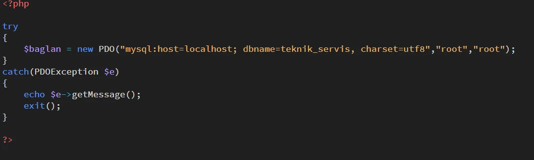

Fatal error: Class 'PDO' not found problem
I've just started using PDO, I'm using dreamweaver 2021 and I'm getting this error, I tried many things, but I couldn't figure out what I did, I would appreciate if you could help.

    BenPleysier
    Jun 5, 2022 5:40 AM UTC
    This error reports that the web server was unable to locate a PHP module called “PDO” in the server. Web applications require this PHP module to establish a database connection.
    Have a look at the compiled mosules list using the phpinfo() function.
    To do this, create a new file called phpinfo.php and as the only instruction, type `phpinfo()` (without the `) and run the file. This will give you similar to
    If you do not see the above, then you will need to go to `php.ini` to enable the extensions.
