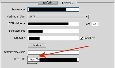

    Found the culprit after all:
    The web-url in the server settings was still 'http://'. It obviously must be 'https://' now:
    With https it works fine again. Thanks for all your assistance.
