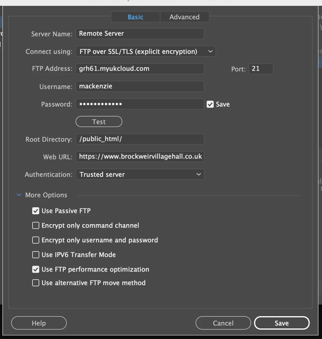

    Jul 8, 2022 11:59 AM UTC
    As an update, to further help diagnosis, I uploaded an image using Filezilla, then downloaded it back my local site, changed the name, then from the files tab in Dreamweaver tried to upload it again, and it failed with same error message. I attach a screenshot of the DW definitions window.
