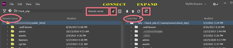

    I'm not exactly sure what you're asking.  Buttons inside the Files Panel (F8) cannot be moved if that's what you mean.
    In the screenshot below, my local site folder and remote server are defined in DW (Site > Manage Sites...).
    In this second screenshot, my Files Panel is fully expanded and connected to my site's remote server.  To un-expand panel, hit the Expand icon a 2nd time.  To disconnect from server, hit the Connect icon a 2nd time.
    If that's not what you're asking, please come back and elaborate with a screenshot so we can see what you see.

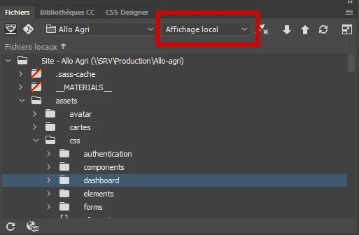

    B i r n o u
    May 25, 2021 11:11 AM UTC
    when you hover over the left edge of the palette, the cursor turns into a double horizontal arrow, you can then click and drag and extend the width of the palette

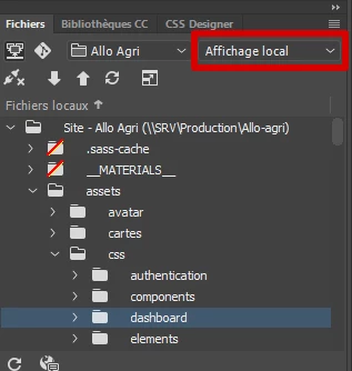

    May 25, 2021 9:55 AM UTC
    just expand it on width... you will so realign the toolbar... you can access to remote file using the selector
    Not expanded
    now expanded
