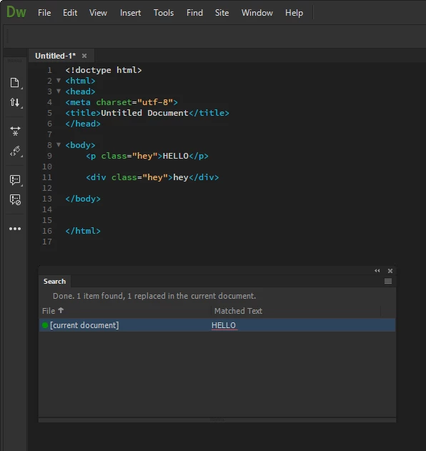

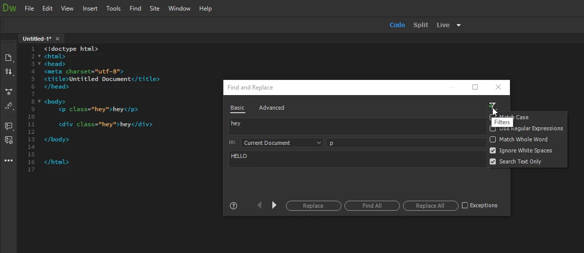

    Yes, that's true - but can you replace only part of a string in a
    specific tag and leave the rest? I don't see how....
    We can of-course replace a particular string in the inner html of the tag without touching its outer html. I can better explain you with the example below:
    1. I am trying to replace "hey" with "HELLO" in the Design view text of <p> tag only.
    2. I am making use of the filter "Search Text only" which makes a Design view Search and as you can see below, it hasn't touched any other instance other than the one in inner html of <p> tag.
    Hope this helps. I am still expecting that you will share the query which used to run in CC 2015 and is not working in CC 2017.

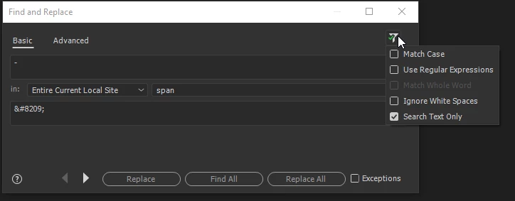

    The tag search in Find and Replace dialog now as per Dw 17.5 works exactly the same as it used to in Dw CC 2015, I assure you there is no change at all. So can you share the search and replace query that you used in CC 2015 which worked and is not working in CC 2017.5?
    Although, we now have one more option to search in [any tag], please use the settings as per the snapshot below and see if this works?
    Niharika Gupta

    Jul 5, 2017 6:17 PM UTC
    Hello Niharika,
    In your example, wouldn't that replace all hyphens in ANY span with the code?  We only wish to replace hyphens within spans that have the class "ItemNumber".

    Jul 6, 2017 6:03 AM UTC
    Yeah, this will replace any hyphen that is there in the "Design view" text in any span tag. For your specific case, I am not able to formulate the exact query from the Find and replace options that are available.
    Although, you mentioned that you were able to fulfill it through CC 2015, so I was wanting to understand the query that you used there.
