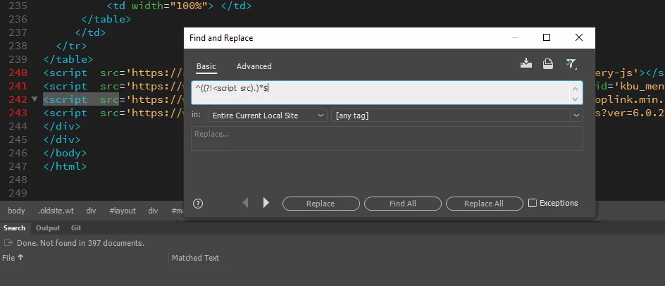

    If I do exactly what you say and use the regular expression ^((?!<script src).)*$ I get Not Found in 397 documents.
    I assume the question and exclamation marks are not bold (hard to see on my screen).

    The search you give works perfectly here, same version of DW, same OS.
    Did you check the box for Use Regular Expression (step 3-4 above)?
    Without that checkmark in place, the search string doesn't run.
