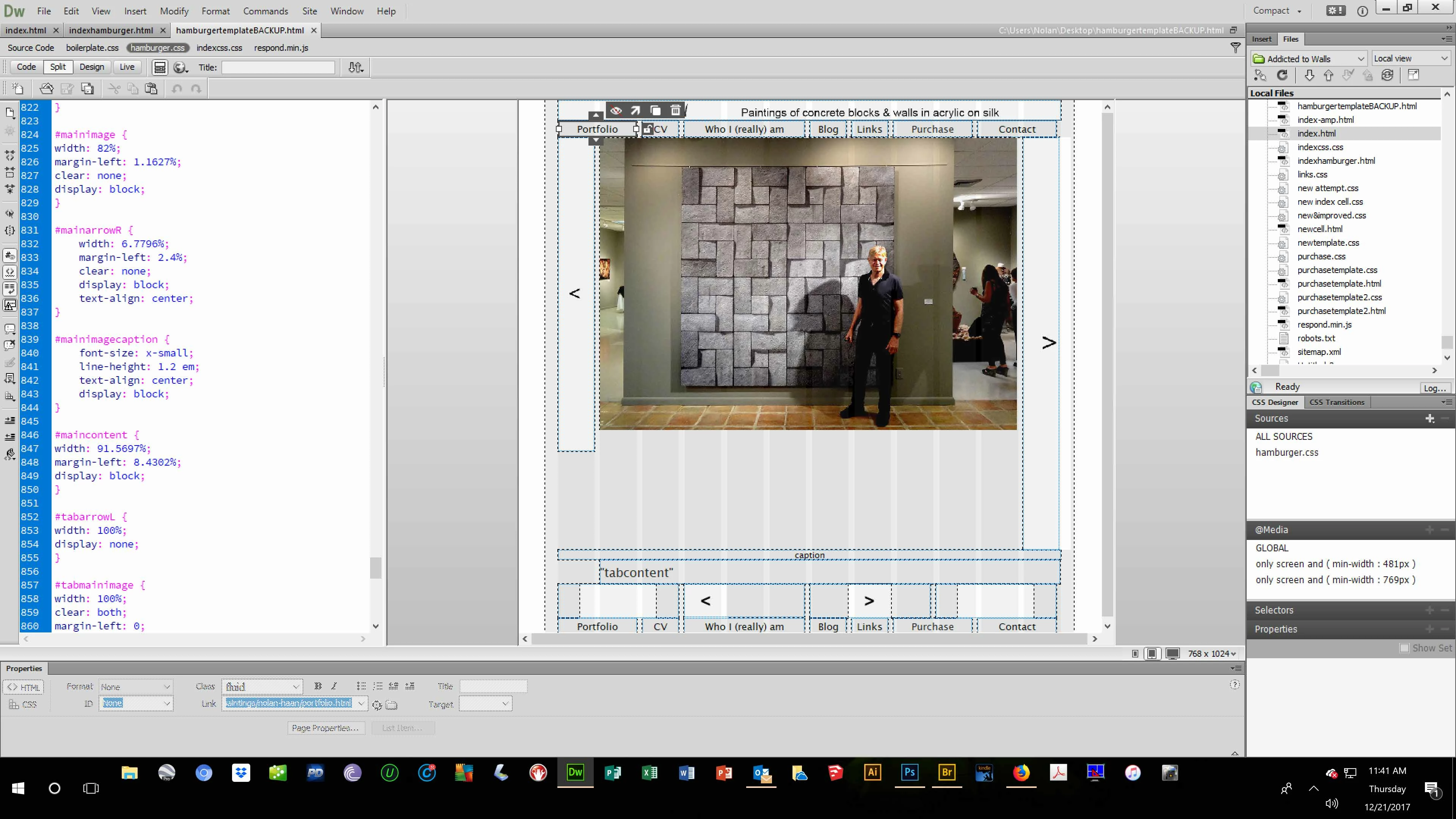

Thanks Jon. I originally sized the divs as follows: 1 column, 10 columns, 1 column across a 12 column grid. Even if I paste the same image into each of the identical side divs, the right side comes out much longer than the left one, and each is longer than the main center image (even though all the images are 700px. The css code for each side div look identical.

I'm sorry, but your image doesn't really tell me anything about your code or your problem, aside from showing me you're using a Legacy Fluid Grid Layout and have some css written, also that you're in Design View. That last one raises a question, is the problem in Design View, Live View, in the browser when testing the page or all of the above?
In order to get help with something that's driven by code, we need to see the code. The easiest way to do that would be to upload your work in progress to a test location on your server (I suggest a folder called TEST), then share that location with us via a link (www.yourdomain.com/TEST). Once the problem is solved, you simply remove the test location from the server along with the content.
