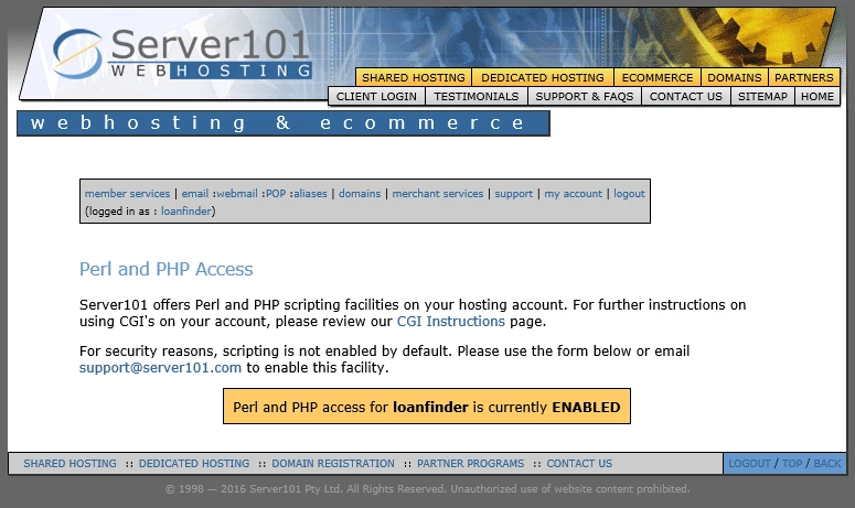

#1 - I thought so, previous website going back 10 years allowed form email to be sent. I sent the current host an email to clarify if PHP Mail () was enabled and available. When I log on to my hosting account, it suggest it is. ( see pic )
