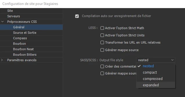

Mar 23, 2022 9:59 AM UTC
Have you try to modify the output file style accessible from the site configuration, preprocessor CSS category ?
Mar 24, 2022 7:22 AM UTC
Hi, thanks for the reply.
I am using npm in terminal to compile SCSS into CSS, so I did not have that site configuration option set up. So, I tried your suggestion but it did not alter the SCSS file (maybe I did it wrong somehow). Anyway, to be clear, what I am looking for is a way to tidy up and "beautify" my scss files, so that they are easier for other people to read - in the same way that you can do "Edit > Code > Apply source formatting" for HTML files. At the moment I copy my SCSS into Codepen,  then click "Format CSS". Codepen tidies the code up, then I copy it back into Dreamweaver. There are also tools like https://codebeautify.org/scss-beautifier. That is the kind of thing I was hoping to find inside Dreamweaver, to help me become more efficient.
